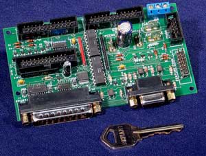

CandCNC Universal Breakout Board (UBOB)
CNC UBOB
Download:
ccc_ubob.zip
Author:
M. McKnight/T.Caudle
Version:
2.10
Status:
Full Release
Feedback:
CandCNCSupport Yahoo Forum
Website:
www.CandCNC.com/UBOB.htm
Special Features:
Supports UBOB hardware with TDM port expansion
9 Fully Isolated inputs for Homes, Limits, Probes and Expansion card signals
8 High Speed S & D outputs. 4 independent Axis. Hardware slaving for 5th axis.
6 High current (double buffered) outputs for relays
2 Internal Outputs for DTHC and Spindle Speed Expansion Modules

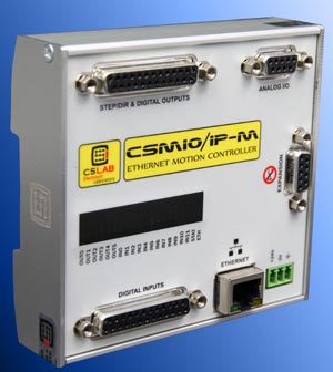

CSMIO/IP-M 4 Axis Ethernet Motion Controller
Author:
CS-Lab Electronics Partnership Co.
Version:
Hardware v1.0
Firmware v1.201
Status:
Full Release
Feedback:
CMSIO-/IP Forum
Website:
Special Features:
PC connection via Ethernet
4 axis controller
12 digital inputs and 6 digital outputs (full optical isolation, short circuit and thermal protection on digital outputs)
4 analog inputs / 2 analog outputs (0-10V).
Max. STEP frequency of 125kHz with a 50% duty cycle
Ability to connect the CSMIO-MPG module

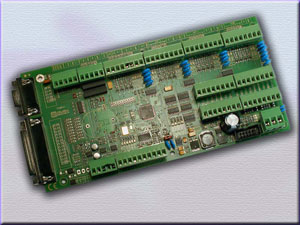

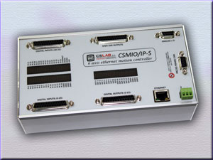

CSMIO/IP-S 6 Axis Ethernet Motion Controller
Author:
Version:
Hardware v2.0
Firmware v1.2
Status:
Full Release
Feedback:
CMSIO/IP Forum
Website:
Special Features:
PC connection via Ethernet.
6 axis controller.
STEP frequency to 4MHz (differential outputs, very resistant to interference).
Extremely stable machine speed control, thanks to the FPGA and advanced control algorithms.
32 digital inputs and 16 digital outputs (possibility to extend to 192 inputs / 96 outputs through additional modules).
All I/O are optically isolated, protected against short circuit, overheating, industry standard - 24V.
Up to 3 slave axis support, machine geometry correction.
Spindle inverter control through analog outputs.
An extension of functionality through additional CanOpen modules. Currently available modules:
  • CSMIO-IO – module of 16 additional inputs and 8 outputs (24V, optical isolation, overload protection). Possible connection to 10 modules like these.
  • CSMIO-MPG connection modules – smooth control of the machine motion, automatic switching between speed and position mode.
  • Work is underway on the CSMIO-SCAN module - to operate a laser scanner.
Solid aluminium enclosure that discharges the heat very well and perfectly protects the electronics of the device.
Comfortable Din-rail mounting.
Succesfully developed software and the ability to update by yourself.
Ability to control all digital and analog signals by VisualBasic macros.
Support for the FAULT signals of the servodrives – immediate machine stop in case of failure on any axis.
RESET support for the axis drives.
Readable LED controls on the front panel for easy installation.
Future updates will support screw mapping and threading.

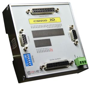

CSMIO-IO Expansion Module (additional I/O for CSMIO/IP-S-A)
CSMIO-IO
Author:
Version:
Status:
Full Release
Feedback:
CMSIO-/IP Forum
Website:
Special Features:
It can be connected only to CSMIO controllers (the controllers are designed to automatically detect connected expansion modules)
An extension module with 16 additional digital inputs and 8 digital outputs
Communicates with CSMIO/IP via CAN bus
Possible to connect to the expansion bus up to 16 CSMIO-IO modules for a maximum of 288 digital inputs and 144 digital outputs
All module inputs and outputs work with standard industrial 24V power supply voltage and have full optical isolation with additional protection against short circuit and overheat.

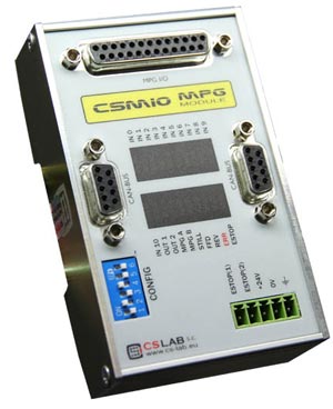

CSMIO-MPG Expansion Module (for CSMIO/IP-S-M-A)
CSMIO-MPG
Author:
Version:
Status:
Full Release
Feedback:
CMSIO-LPT Forum
Website:
Special Features:
The module can be connected only to the CSMIO controller(s)
MPG (JOG) support module for manual axis operation
Equipped with 3 digital multiplier inputs (x1 x10 x100), 6 digital inputs of controlled axis selection, 2 independent inputs, 2 independent outputs, 2 analog inputs to connect potentiometer for feedrate correction and spindle speed correction, input and output of the emergency STOP
Digital inputs and outputs are inside optically isolated and filtered. All is closed in a compact cover mounted on a DIN-rail, what means that the mechanical and electronic installation in the control cabinet takes less time and is simpler.
CSMIO-MPG requires standard industrial 24V power supply voltage

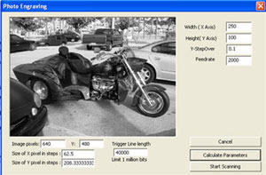

Engraving Trigger for Laser or Impact
Engraving Trigger Screen
Download:
Engraving Trigger Plugin
Engraving Trigger Source - Source code for the Engraving Trigger plugin. Feel free to download and modify as needed to fit your application.
Author:
Art Fenerty
Version:
2.00.076
Status:
R & D
Feedback:
Website:
Special Features:
Imports Photo and outputs DigTrigger at variable number of 5us pulses to trigger laser to grayscale output of image during X motor output

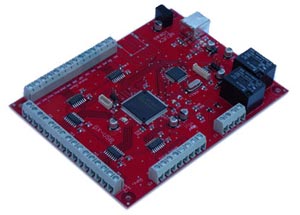

GX-USB
GX-USB
Author:
Nevex Tecnologia
Version:
2.1
Status:
Full Release
Feedback:
email: info (at) nevex (dot) com (dot) br
Website:
Nevex Tecnologia Website
Special Features:
USB Motion controller.
200 khz step frequency.
4 axes.
12 Digital inputs.
6 Digital outputs.
2 relays.

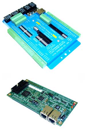

HiCON Motion Controller
Author:
Vital Systems Inc
Version:
Check Vendor Website
Status:
Full Release
Feedback:
HiCON Forum
Website:
Vital Systems Inc.
Special Features:
6 Axis Step/Direction with 2MHz Max Step Frequency
Optional Encoder Feedback for all 6 Axis
9 Hardware Differential Encoder Inputs, 4 MHz Max freq.
Encoder Resolution Magnify by 4 in Hardware
High Performance MPG Control
Probing
Lathe Threading
Backlash compensation
Homing Using Home Sensor and/or optional Index Pulse
Rotary Axis Homing with Index pulse
Use One Home Sensor Input for all axis, or separate Home Sensors for each axis
Option to use Limit switches as homing sensors
Instant FeedHold with Decel
Slave Axis Support
Smart Spindle: 0-10v / +-10v / GCode Axis as Spindle
Fast 10/100 MB Ethernet Communication with PC
High Speed 3D machining support
Digital 52 Inputs, 30 Outputs
HiCON Basic Macros for fast internal I/O logic programming

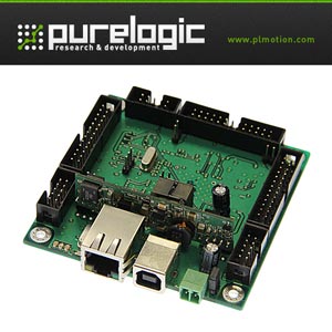

PLCM Series Devices
Author:
PureLogic RnD
Version:
Status:
Full Release
Feedback:
PureLogic RnD Forum
Website:
PureLogic RnD
Special Features:
Ethernet or USB Full-speed connection
Up to 6 axes, 100kHz pulsing engine
PWM spindle control
Probing
Torch Height Control
Slave Axis support
Soft limits
Easy firmware update
DB25F connector to reproduce standard LPT connection

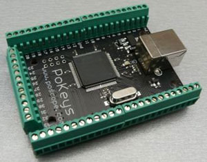

PoKeys Plugin
PoKeys I/O Device
Download:
PoKeys Plugin
Author:
PoKeys
Version:
.01
Status:
Alpha Release for Testing
Feedback:
PoKeys Forum
Website:
PoLabs
Special Features:
Support for PoKeys55, PoKeys56U and PoKeys56E devices
Multiple PoKeys devices supported
Usage of PoKeys Pulse engine (available on PoKeys56U and Pokeys56E devices) as external motion controller for Mach3 – 3 axes, each up to 25 kHz step frequency
Mapping of PoKeys digital inputs (up to 55 inputs) to Mach3 OEM LEDs and OEM buttons
Mapping of Mach3 OEM LEDs to PoKeys digital outputs (up to 55 outputs)
Mapping of Mach3 OEM LEDs to PoExtBus devices (up to 80 outputs)
Mapping of PoKeys encoders (up to 26 32-bit encoders with selectable hardware pulse multiplication) to Mach3 DROs
Support for matrix keyboard (in sizes up to 16x8) with mapping to Mach3 OEM LED or buttons
Support for kbd48CNC keyboard with mapping to Mach3 OEM LED or buttons and mapping of Mach3 OEM LEDs to kbd48CNC LEDs under keys
Ability to import/export settings of the plugin for sharing the plugin configuration or deployment
